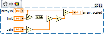

Accepted by topic author victorlarsson

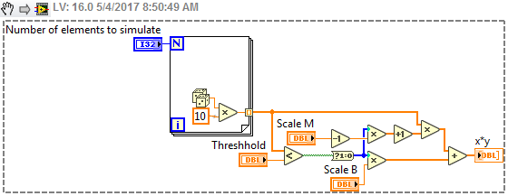

loopless:
(loopless doesn't mean it's more efficient… :D)
Edit: Damn, Jeff was faster… 😄

Implemented the way the problem was stated.
The other solutions look cool and may not use loops, but they use some unusual "hacks" to do that.  It may not be as clear to someone else reading the code as to what is going.
I'd prefer clarity.

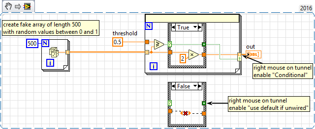

i want kudos too 😉
If Tetris has taught me anything, it's errors pile up and accomplishments disappear.
Message 7 of 16
(6,403 Views)
@jwscs wrote:
i want kudos too 😉
Sorry.  No kudoes.  A conditional tunnel determines whether a value is included in the output array or not.  You created code that only outputs an array of values that were multiplied discarding all the ones that weren't.

you got me 😉
