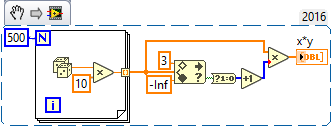

Another way:
Ben64
Message 13 of 16
(1,012 Views)
What impact does the IR&C have compared to GT?
I agree that it will work but, did you benchmark the code and find an advantage?
Message 14 of 16
(1,006 Views)
I take back my earlier agreement.  Toss a NaN in there.
And how did you actually scale the inputs by a factor of x?
Message 15 of 16
(1,004 Views)
This is the disadvantage here, it is fixed to 2 but in this case this is what the OP wanted.
Message 16 of 16
