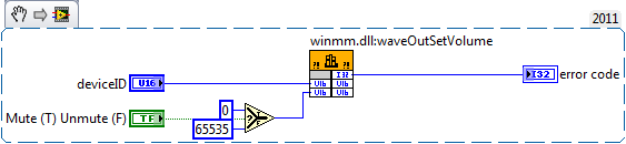

Have you considered using the waveOutSetVolume function inside winmm.dll, and writing '0' to mute the volume or '65535' to unmute the volume.
I have attached an example that achieves this functionality:
Jared A.

Thanks so much for responding back to me. This is an option that I was thinking before and unfortunately it does not satisfy my goal. Here is an explanation why it would not fit properly: If I would execute your code and at the same time open up volume control in windows, executing your code would not do anything to the mute check box in volume control it would only increase or decrease the slider on the actual volume but nothing would happen to the actual mute control. My goal is to be able to check on or to check off that Mute box in volume control using winmm.dll while running LabVIEW.
Please feel free to provide any further suggestions that would help me to resolve this problem.
