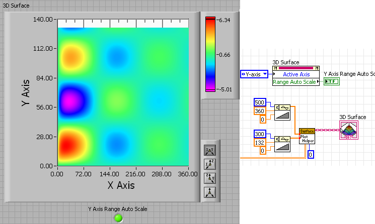

Another AutoScale bug.  This time with a picture, no video.
The range for the Y data is 0-132, which you can see in the block diagram picture where I used the Ramp VI to create the Y Vector.  Additionally you can see that the Y axis is supposed to be autoscaled by the LED on the bottom of the front panel.  You can also see that the graph is clearly not autoscaled since the Y axis goes from 0-140.  I suspect it's doing a sort of 'Loose Fit' like you can do with the 2D graphs.
Tim Elsey
Certified LabVIEW Architect
Message 15 of 54
(3,685 Views)
It looks like the autoscale bug is a bit stranger than it first appears. The loose-fit view only happens for values above 100, and does not appear when the value is divisible by 10 because the window automatically uses the next "10" as the axis maximum (101 has an axis max of 110, 111 has 120, etc). This has been filed to R&D, CAR#316928.
