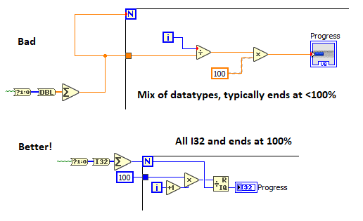

Datatypes have been mentioned. Whenever you change the representation of a numeric, LabVIEW will need to make a datacopy and convert to the new representation.
Here's a quick example of what you do and what you should do instead:
In this code fragment, we want to run a FOR loop as many times are there are TRUEs in a boolean array and monitor the progress.
TOP (your code):
Boolean to 0,1 outputs I16 so the sum will be incorrect if the result is expected to be larger than 2^31-1. Thus we need to convert to something with more bits. The result is an integer, so DBL is definitely wrong. You can see the red coercion dot at the N where LabVIEW trims it down to I32 again.
For the progress, you divide the I (I32) with your DBL, multiply with a 100(DBL), then shove it into a progress bar that is U8. Look at all these coercion dots. You code has the measles! Since N is always larger than [i], there is a change that your progress bar ends at <100%, confusing the operator.
BOTTOM (Better alternative)
The correct choice is I32, because that's all the N of the FOR loop accepts and also the maximum array size. It is guaranteed not to overflow! We use "i+1 so we are guaranteed to end at 100%. We multiply by 100 first so we can do an integer division later. We change the progress bar to I32. No everything is the same datatype. No coercions!
Message 6 of 8

@altenbach wrote:
For the progress bar, I rather not repeatedly do the math inside of the loop.  Instead, I set the scale range maximum of the bar to the number of times I will iterate.  I am subtracting 1 here because i starts at 0 instead of 1.  The bar will fill up as the loop iterates and be full at the end.
Message 7 of 8
(3,347 Views)
Yea, but that math is typically peanuts compared to anything else (and if the loop is very fast, we don't need a progress bar!). 😄
(I am not sure about the cost of changing the scale, because that involves a (synchronous?) thread switch to the UI thread. The coercion is somewhat ugly too...;)) My code could be wrapped into a tiny inlined subVI with i and N as input and progress as output.
The fun starts if you want a progress bar for a parallel FOR loop. Since [i] will be all over the place, you need to jump through some flaming hoops anyway. 😉 (Here is an early draft).
