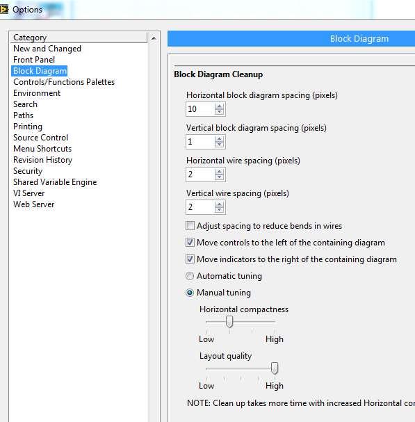

Since a picture is worth 1000 words.
This is how I set up ctrl+U options (Tools>>Options)  Play with them yourself to tweak it however you want.
