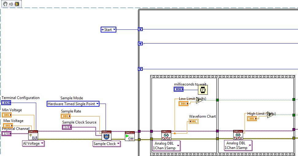

im really new to Labview and im trying my best.i have a NI myDAQ and i have a Filter bank connected to it (Filter bank contains Highpassfilter + lowpassfilter in DIO ports). my goal is to generate a signal and to plot the highpass and lowpass response to it. I am not allowed to use the Elvismx functions (Function generator+ oscilloscope).
i know that its not complicated, but im really new to this and i have no clue 😞
i thought maybe to do somthing like the screenshots, does it look like a good start?1.png2.png

Hi Ayman,
In those screenshots (showing only smaller parts of your whole code) you just read from AI channels.
How does that relate to your goal of "generating a signal"? How does it relate to "filter bank in DIO ports"???
Why do you use the "hardware timed single point" acquisition mode?
Why do you need to read 2 samples in the upper image, just to compare to two different limt values? (Why do you need a sequence frame here?)
Why do you need two IndexArray nodes in the lower image? Why not just resize IndexArray to read both samples/channels?

Hi GerdW,
i used these screenshots as an example, i didnt write the code but i thought that it could work on my problem. The problem is, i never worked with myDaQ and i didnt found good examples for my problem. when i search about my problem: all people use the Elvismx modules (the function generator vi and oscilloscope vi).
i would really be thankful for any suggestions !!
