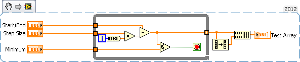

This seems like it should be relatively easy to acheive, I've managed to break it all down to a minimal program. The most difficult part is the incrementation which I managed by using a while loop, this could cause some problems if you put the values in wrong but thats pretty easy  to safegaurd against.
Once you have the increment array you can simply put it into an auto-indexing for loop and use the same measurement/set controls for every loop. The only real difference here is that this uses 1.0, 0.9, ..., 0.2, 0.1, 0.1, 0.2, ..., 0.9, 1.0. But that shouldn't be a problem.

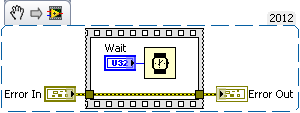

If you download the PNG and then copy it across you should be able to load it into LabView as a snippet. Its basically taking the inners out of your main VI, flatten it out and put it inside a for loop. Although, one very helpful hint that I picked up along the way to help with timing is:
It means that assuming you have your dataflow correct and everything follows the error lines you can make the program take a pause in the middle of a diagram without needing to encase the entire diagram in a Stacked or Flat Sequence.
