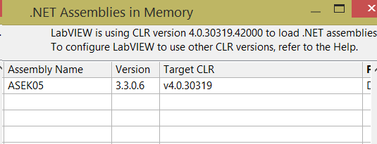

I also am not sure about what I should configure on this part of the file:
        <assemblyIdentity name="AssemblyNameWithoutExtension"
                          publicKeyToken="b03f5f7f11d50a3a"
                          culture="neutral" />
        <bindingRedirect oldVersion="1.0.0.0-1.5.0.0"
                         newVersion="2.0.0.0"/>
      </dependentAssembly>
When I'm using the development mode I can see the version of the .Net assembly and that the configuration file is loading the assembly to v4.0.30319, if I don't put the config file, it doens't even load the assembly.
