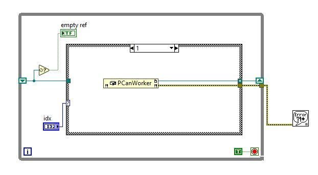

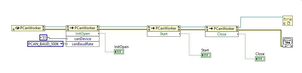

This running in one line works:

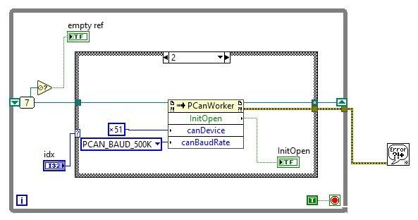

BUT: This does not work (any more):
So, if you use the .NET reference in one line, it works.

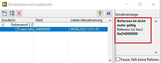

If you use .NET reference in a shift register of a FGV, it looses the reference. The Probe tells me then:
The reference has an ID, but this ID is not valid any more.
But I have not closed the .NET reference in the meantime.
It does not store the reference in FGV shift register between iterations.

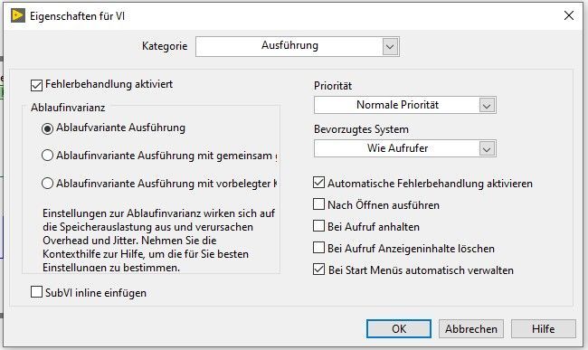

VI Properties are standard:

Do you see the reference tunnel on the right side of the case structure?  It is set to "default if unwired".  Check that the reference is wired through all your cases.
Bill
CLD
(Mid-Level minion.)
(1,633 Views)
OK, seems to run now.
I think it was my mistake.
Thank you!
