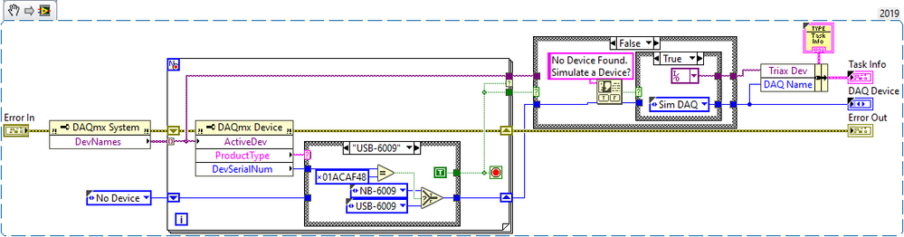

Feel free to adapt this VI I wrote to "find DAQmx Devices" for me.  This particular version is looking for the first 6001 that it finds (note the code to find a specific (by serial ID) unit has been "commented out" by having the equality test replaced by "True").  In some cases, I don't stop on "First Find", but let it run through and present me with a Choice ("Which Camera do you want to use?").
Oops, I posted without attaching, then found I'd already saved a Snippet (which didn't exactly match the version I was going to attach, so some of the description above is "for the other version").  Talk about your Absent-minded Professor ...
