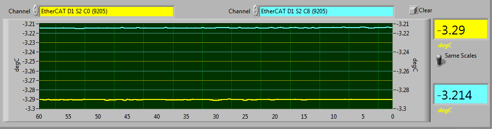

If I set chan 0 to be RSE, and chan 8 to be RSE, then I get two distinct channels, as expected.  Here's the debugging log from configuring it that way:
And here's the data (nothing is connected to the input lines):
No surprises there.
Now, if I set Chan 0 to DIFF and chan 8 to DIFF, I would expect either an error, or duplicate data, because they're really only one channel now.  But I get neither:
OK, now for the impossible situation - if I set chan 0 to RSE, then chan 8 ought to be separate.  But if I set chan 8 to DIFF, then chan 0 ought to be paired with 8.  THIS HAS TO BE AN ERROR.  But I get no error, and the data is still separate:

Steve,
and check me as I wander down dim reaches of memory.....
Ch8 = Diff is ignored.  Reasoning: ch0 must be diff to set ch8 to ch0-  If I recall correctly, there is no way to "Really" set ch8 to diff (since it is set as a ch0 property.)  DAQmx just prevents the insanity by ignoring what would appear to the device as "Some id10T isn't reading the manual"
One COULD argue that "ch8=Diff" and "ch8 not consistant with ch0 mode" should throw warnings.  You could argue that!  But, you would likely lose the argument to the team that wrote it the way its written.
