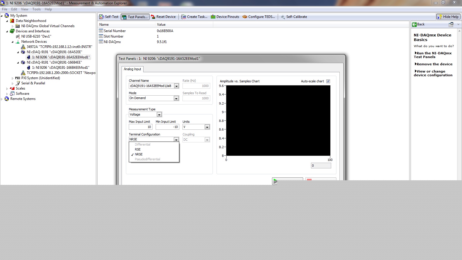

I have a NI 9206 card that has 16 differential inputs for some reason inputs 0-7 I can place as differential but inputs 8-16 grey out the differential option in Terminal Configuration. See picture below. Help on this would be greatly appreciated.

For differential DAQ channels, AI0 through AI7 are the positive and AI8 through AI15 are the negative.  So, when in differential, AI0 is the difference between AI0 and AI8.  This is why you can't set 8-15 to differential.

There are a total of 32 inputs so AI0 through AI15 are the positive and AI16 through AI31 are the negative which would give me the 16 differentials. Its card NI 9206.
Message 3 of 12
(5,058 Views)
Sorry I see what your saying now I assume the card was layed out AI0 to AI15 on the positive side and AI16 to AI31 on the negative side, but its actually AI0 to AI7 and AI16 to AI23 on the positive and AI8 to AI15 and AI24 to AI31 on the negative side. Thanks for you help.

Yeah, I should have mentioned that the differentials are in sets of 8 pairs.  But it seems that you have it figured out
