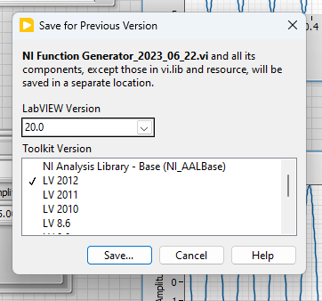

NI 9264 to produce 3 phase waveforms and shown in 1 chart
I can't see the option to save in 2020.
Please advise.

I got it.
Which version you want me to save the file?

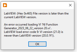

I got this message

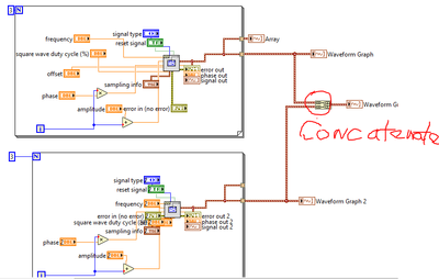

Each for loop is alredy generating multiple waveforms.
If you want to combine both outputs (from the loops) into one graph you need to change the build array to accept CONCATENATE inputs , right click on the build array and select CONCATENATE.

Thank you sir! I just did combine signals and it worked too.
