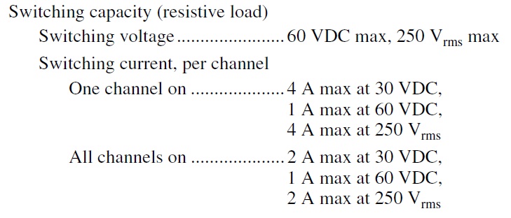

Hello Rbeery,
Can you check  that during the operation of the 9481 none of these parameters are exceeded??
Regards
Mart G
