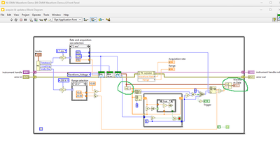

I looked into one such example (NI-DMM Waveform Demo.vi). It has a subVI, acquire & update.vi. It does not interact with t0 component, only Y, the 1d dbl component. (Please see green circles in screenshot)
If t0 is not interacted with, then it's probably because it comes from a constant 0? Nothing changes the 0, so it stays as 0.

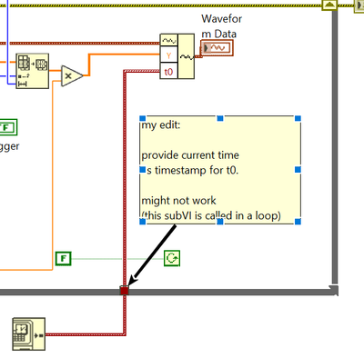

If you need to interact with the t0 component, at some point you need to provide timestamps, like this:

I'm trying to do a hardware triggered measurement, use current time as t0 doesn't work for me.

You could try creating a timestamp that aligns with your trigger. For example, you could set the DMM Trigger as its clock and call the Get Current Time function alongside your trigger. That way, each "block of samples" will have its own t0 timestamp and when that "block" is added to a Waveform Chart, you can accurately see each block's position on the chart.
Alternatively, you can read about how DAQmx functions handle timestamps here.
Can I ask for more details about your project? Maybe you don't need to specify a t0 at the time of acquisiton - instead, if the data is continuous, a single t0 timestamp after the acquisition starts may be enough.
In short, we need to understand where in your code/acquisition do you need to set a timestamp. What are you trying to accomplish?
