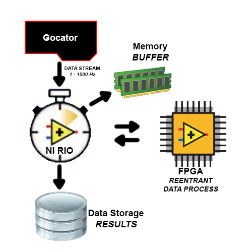

. Scanning with PC was possible, but only for a certain phase with low performance. The PC was unable to receive the amount of data from the Gocator and for further precision scanning I want to use the Gocator on 100% performance. To solve the issue, I wanted to setup the system, showed at 1. Figure, where the Gocator streams the data with 1-1500Hz frequency, what the NI IC RIO stores in a FIFO buffer then pass it to the FPGA for process. The processed data is saved later in the Data storage.

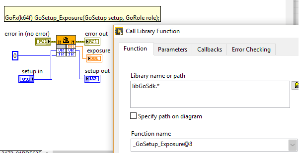

The company who made the Gocator LMI3, provides an SDK for further development. From the SDK, they compiled .dll-s and in Labview they use the Call Library Function module to call the compiled functions in the libraries written in the SDK.
The first problem was, that if I wanted to deploy the Labview project to the IC, obviously the .dll-s haven’t worked, because the operation system is Linux. To recompile the SDK to NI Real-Time Linux Shared Libraries (.so file extension), National Instruments provides a solution and a tutorial also, which I was aware with. However, that solution is only possible with Eclipse projects and our SDK was in Visual Studio solutions. I found the solution where I deployed the SDK to the IC and recompiled everything there, because I had a .mk file in the SDK for linux useage. The deployment of these libraries is necessary, due to the fact, when we deploy a Labview project, the .dll-s and .so-s are transparent. The deployment of the shared libraries was done through SSL into a specified directory, where they are loading automatically during IC boot (/usr/local/lib/).
I had to modify and rewrite all the functions given by LMI3 in the SDK, because of the change of the shared libraries path. As you can see in 2. Figure, every CallLibraryFunction module must be set to call the relative path of the shared libraries.
calllibrary.pngI arrived at the last phase before the actual scanning. I set up the communication protocols and when I run the VI, I lose connection with the IC.
