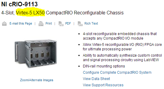

I am trying to download the  Xilinx Tools 10.1 to use with a 9113 chassis in LV2011.  Based on this white paper the compiler below should work just fine.  The problem is I can't get it to download all the way.
I can't seem to get past ~336MB using the standard or NI downloader.  Any ideas?  Anybody else having this problem?

Well... on the bright side, you don't want 10.1 anyway!
Virtex-5 LX50 <- REQUIRES Xilinx 14.4.
10.1 is only for Virtex-II devices! (...after LabVIEW 2009 that is, just so everyone reading this knows).
soo.... try this link: http://www.ni.com/download/labview-fpga-module-2013/4248/en/
Cheers!
TJ G

Whoops, I was getting mixed up with the 9103.....
        thanks,
             -PBD
(3,690 Views)
crap
I need to read better. you said 2011: in LV 2011, you'd want Xilinx 12.4: http://www.ni.com/download/labview-fpga-module-2011-sp1/2882/en/
Sorry about that.

No problem, straightened me out either way.
