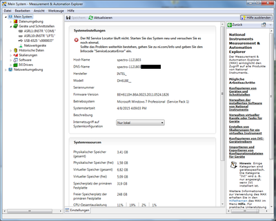

I tried to install the NI Device USB-6525 when I noticed some problems with my Labview installation.
The first is that when I open NI MAX the program shows the message "NI Service Locator not running"

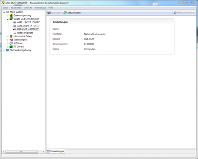

And the NI USB-6525 device is shown as available but I can't use or configure it.

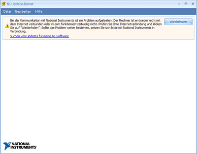

Then I tried to solve this problem via updating Labview but the NI-Update Service says that there is a communication problem.

Here are some of my thought/suggestions:
  1. Try running MAX as an administrator (right-click > Run as administrator). This sometimes fixes issues with configuration.
  2. The NI USB-6525 requires the NI-DAQmx driver. Can you verify that the driver is installed? You should see it listed under the Software tab in MAX or in Window's Programs and Features under National Instruments Software. You can also try repairing the NI-DAQmx driver. Order does matter, so you'll want to do driver installation/repairs after LabVIEW is installed/repaired.
  3. You also need NI Configuration Manager and NI Device Loader services to be running. Sometimes these services turns off after a new installation, so make sure to reboot your computer after installations/repairs for these services to work properly. If these services are not starting properly upon reboot, please see more informationn this KnowledgeBase: Why Are NI Device Loader (nidevldu) and NI Configuration Manager Services Not Startin...
  4. Do you get any errors when you try to restart NI Service Locator or NI System Web Server?
  5. According to this KnowledgeBase article: Error: NI Service Locator is Not Running, in addition to restarting the services you may also need to make sure your firewall allows NI Service Locator and NI System Web Server. The fix depends on which firewall you use. For example, Windows firewall has these steps.
Sorry to hear about the trouble you're experiencing. Hope this helps!
