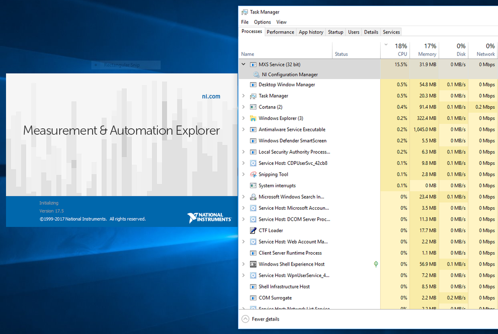

I cannot get NI Max to launch. The splash screen shows up but it never gets farther than that. No error message or anything, just hangs at the splash screen. I think this might have something to do with the NI Configuration Manager as that is constantly using about 15% of the CPU. Any thoughts on how I can fix this are appreciated. I have also attached a screen shot of the splash screen and task manager. This is a pretty fresh install of Windows about the only other software installed is Chrome and SourceTree.
Thanks in advance

I managed to get it to open by just killing the configuration manager. Max eventually opened up with some warnings. Then I reset the configuration data rebooted and everything seems peachy keen now. Also fixed another problem where opening an existing project with DAQmx stuff would hang for about a minute. Not sure what went wrong, but resetting the configuration data seemed to be the answer.

Yes I mean I used Windows task manager to end the NI Configuration Manager process. After doing that MAX opened up with some warnings about the configuration manager not running. Then from MAX I reset the configuration data (Tools > Reset Configuration data), restarted my machine and this fixed the problems that I was having. Sorry for the confusion.
