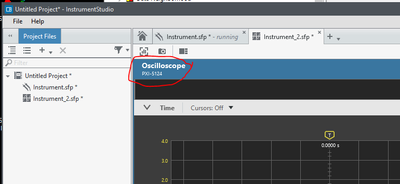

Hi
I don´t know if you ever found a solution on this problem, but I have a similar with NI-5124 Scop when upgrading at running system from  a PC with Windows XP to a PC with Windows10.
Her is what I have done:
NI-5124 PXI oscilloscope failing.
  1. It’s placed in a system that has run for 20 years on Windows XP and Labview 8.2.1
  2. PXI rack 1045
  3. Mxi: PXI-MXI-4 (PCI-8336 and PXI-8336)
  4. Now the PC is upgraded to a new one with Windows 10 and LV15.
  5. After new PC the system started, I can see all cards in PXI rack in MAX
  6. I can communicate with all card but not NI5124 Scope.

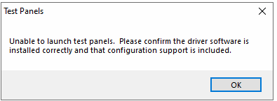

  7. When I try to launch Testpanels for Ni5124 I got the following error:
  8. I can launch Testpanels when I point at NI4070 DMM in MAX.
  9. When pressing Run/Stop I got this error:

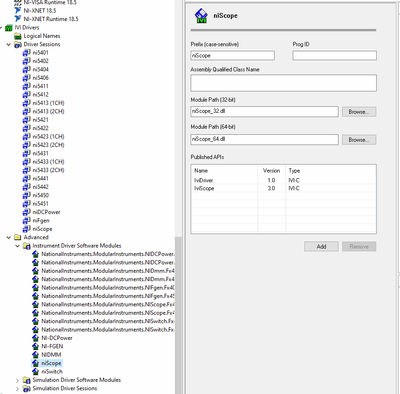

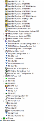

  10. NI MAX pictures:
MAX can´t recognize the type of the PXI bridge, but it is a PXI-MXI-4 (PCI-8336 and PXI-8336)
