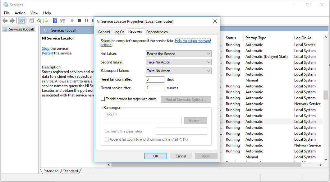

Can you start the service manually? In Windows 10 and I believe through Windows 7 you can open the Windows services by typing "services.msc" into the run prompt. Scroll down to "NI Service Locator" and see if you can manually start it. You can also set it to try to run several times on boot if the first run fails in the properties window (shown below).

The method Steven suggested are the best next steps, also setting the service to Automatic Delayed start will allow it to start later in the startup process of your machine, during this period services can timeout and never get started.

Just as an addition to the service issue, services can depend on one another, this is indeed the case for Device Loader. I have included the full list I have thus far found to require configuring to restart after every failure and delayed start to get reliable performance in some more complex Windows systems and group policies:
1. NI mDNS Responder Service
2. NI Network Discovery
3. NI PSP Service Locator
4. NI Service Locator
5. NI Device loader
6. NI LXI Discovery Service
7. NI Configuration Manager
I would configure all these to restart after failure and start automatically but delayed.
