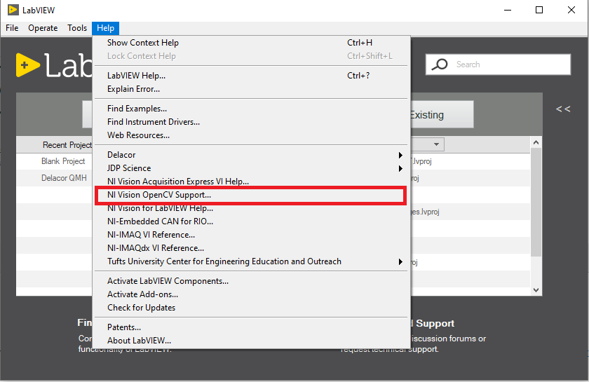

Once you have installed the toolkit via VIPM you can locate the manual in LabVIEW by clicking on "help" on the top menu bar of any window and there should be an entry for the toolkit.OpenCV Support Help.png
