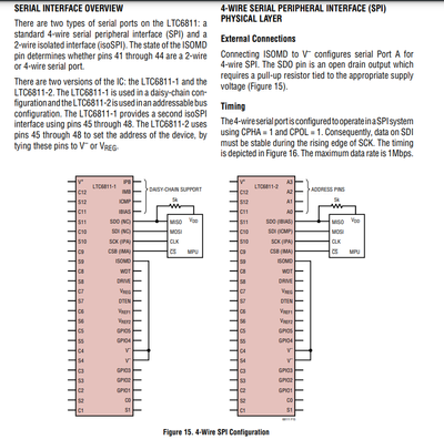

When writing to the LTC6811, it uses SPI Mode 3. However, the LTC6811-1 is not communicating properly with myRIO.
For example, if I send in the command 0x0001 (command code write configuration), with the PEC calculated of the command code of 0x0001 to be 3D6E, and the configuration to be
0xF8 00 00 00 00 00 with it calculated PEC, the response I getting back is 0x FF FF FF FF FF FF, which does not tally. I am supposed to receive back 0xD8 00 00 00 00 00 with its calculated PEC.
Did I do something wrong with the configuration of my VI? Also, do I still need the connection of the 5K resistor to the myRIO VCC MISO input too? I thought the myRIO has internal pull-up resistors for it.
This is based on Figure 15 Pg 44 of the datasheet of the LTC6811-1.

Also, the sampling rate, I don't really get for this, how do I set it? For my current case, I still set the myRIO with 1Mhz frequency for the clock phase = trailing, clock polarity=high.
I attached images from the datasheet for your reference too.

I have solved the issue. There were quite a number of problems in my design of the QSM. I didn't set back the CS lines back to high once a data read is attempted and the clock frequency is too high, hence the read was invalid.
I have since adjusted my clock frequency to 30kHz, and set the CS lines back accordingly. Thanks for the help!
