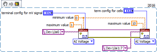

You *can* configure distinct gains / ranges for the different channels.  Here's a snippet to illustrate GerdW's suggestion in msg #2.
-Kevin P
(4,224 Views)
Kevin_price is right, you can set different ranges per channel, BUT be aware you might get some ghosting after switching between channels, depending on your circuit's specifics.
I had an application where I needed to measure 15 channels in the 0-0.1V range, then a 16th in the 0-10V range, and I would see higher voltage than was real after scanning the 10V channel. (Note I was also scanning very quickly- a slower rate will help a lot).
Basically, if the muxed ADC is reading 9 V on something, then it needs to read 0.01 V, it will need some time to "bleed" down to that level. IIRC I was reading at ~50 kHz which resulted in ghosting on the first few channels. Just something to keep in mind.
