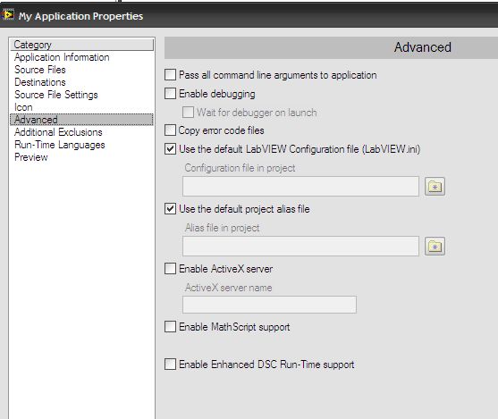

LabVIEW sometimes can seem to have a multiple personality disorder so I certainly appreciate your frustration. There are two I'd suggest. First, can you manually copy this dll in general? Second are you enabling enhanced DSC support in the App builder? Try toggling this option when building the executable (it is on the advanced page).

I would add DSC support but this is only an EXE. But you're correct, my installer Build Specification that I have already made has DSC support checked. All I need now is this EXE to build so I can put it into it.

Craig, three things to try here:
1) Check the Enable Enhanced DSC Run-Time Support checkbox in the Advanced category of the executable Build Specs dialog like Chris mentioned:
