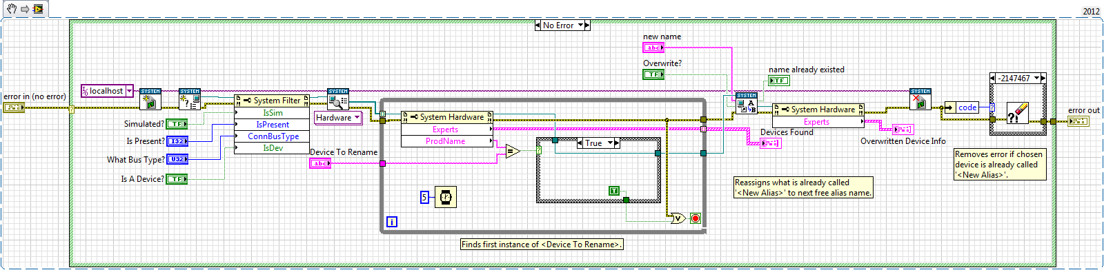

No need to shout or ring my PM box... We are all volunteers here and sometimes we sleep or eat.  besides its a rather simple problem that a search on the forums would have gotten you here
My Tag cloud would have gotten you the this same example snippet :RenameAlias
Just use the system API to find all available serial devices.  figure out which one is your uC (how depends on the connected device) and set the MAX Alias to "MyMicroController" or something meaningful
