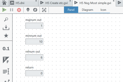

Here is the MSDN page explaining the locations (and the order) where the runtime finds for the DLLs. As per the details in this page, I copied all the files from "HDF5 NET\HDF.PInvoke.1.10.6.1\build\bin64" folder in your attachment to my "C:\Windows" directory. Once I did this and ran the VI, I got this result.
Regarding the issue of no error being thrown, that's a bug and should be fixed in the upcoming version of NXG. Sorry for the inconvenience.
