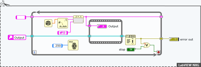

I *assume* that you are doing string concatenation from whatever is arriving in the VISA Read. In this case, your indicator would be scrolled up and your new information will be in the bottom. If this is the case, you can either concatenate from the beginning so new strings come up from the top or use the Scroll to End function, which takes the string indicator reference and performs the scrolling operation to the indicator:
Note how I use a sequence structure to ensure, through dataflow, that I scroll to the bottom after I have updated the value in the indicator. This ensures that the scroll down happens after I have written new information to the indicator.
As a side note, I don't recommend using this approach in a deployment application because that concatenated string will keep filling up the application's memory until it reaches a point where LabVIEW runs out of memory and the applications stops working. If you need to persist all messages arriving to your software, consider logging them to a file. Else, consider limiting your string to a size (or switch to an array where you can add and remove elements easily) to handle how much information you leave in LabVIEW's memory.
