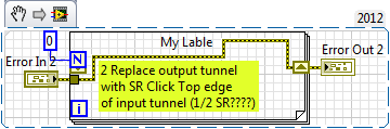

Warning, The following actions were performed on a closed course by a professional LabVIEW Developer.  Do not try this at home.
Not exactly the behavior I would have chosen Smiley Wink I had hoped it was merely cosmetic.  So I tried this:

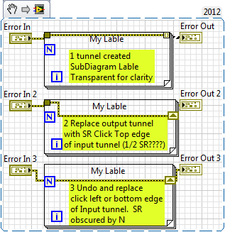

And Error did not propagate A ctrl+u showed why

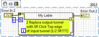

another obscured SR Unitiallized!   That little cosmetic flub could really cause a largeish headache for a developer that does not show warnings by default in the error list.... Of course I doSmiley Wink
