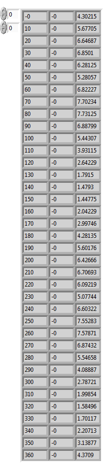

Hi Johnsold,
This is a example of my result. This is only a portion of it. The last column is the amplitude, I store all the 52 points into array and used Array Min and Max function. Then I use max - min to get the amplitude. From the amplitude I cannot see any pattern. Can you please advice me on it. Thanks!!!

This looks like data which could be displayed on an Intensity graph.  Then you could look at the image created and perhaps get some ideas about what to do with it. The eye-brain combination can be very good at spotting patterns.
Make a 2-D array of the amplitudes. The first column would be the data you posted above. The next column would have the data corresponding to 0-360 and 10.  Wire the 2D array of amplitudes to an intensity graph.  Adjust the color ramp to match the range of values.
