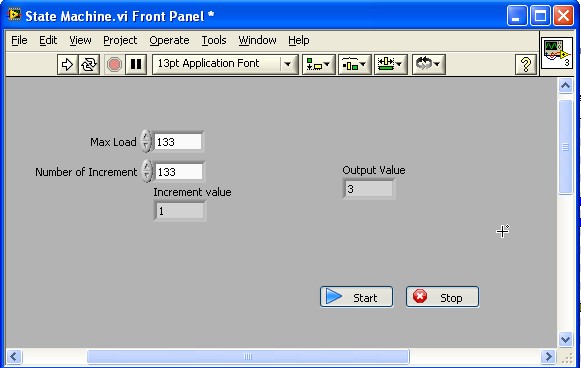

Can anyone help me to please figure out why my stop button can't stop the state machine, I want to stop the program even the program is running.. and it's sad to say for my side that, when i pressed the Stop Button it will only stop until the loop is done. and What I really want is to stop it even the loop is running. I've attached here my vi for your refference..
Thank you and Best regards,
syrpimp
State Machine
Front Panel
Thank you & Best regards
syrpimp

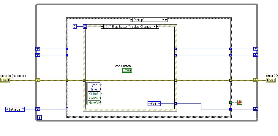

you need to read the stop button either in each state or just after the states. Reading it only in the setup state will not work…
Hiding event structures in cases will also force errors!

You need to read your stop button after the states: outside the case structure!

I'am sorry, I already tried that, but it can't help me. I pulled out the stop button and connect it directly to the contitional terminal but the for loop continue to run..

you cannot stop a loop instantly - you have to stop all the function it contains! THINK DATAFLOW!
So you need to check your stop condition in all states and in all loops embedded in those states to allow an emergency exit…
