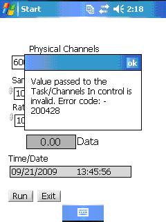

The error you put sounds similar to error -200428
Check out This KB and see if it provides some information, especially the part about putting the create task before the createvirtual channel.

I thought I would create a new mobile app using LabVIEW 2009 andtheMobile Module 2009 with my USB-6009.  I hadn't installed LabVIEW 2009 yet so this is new to me as well.  I to had some difficulties getting the application to work.  I get the following error when I try to execute my code on my Archer PDA.  The next picture is my source code.

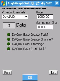

I modified the shipping example to show code execution. The code stops at DAQmx Base Create Task.vi call.  From what I can tell there is no time out that fires to throw an error or let you halt the exectuion.  You have to stop task from the Windows Mobile applet.
I added the indicators to help see what would get executed.  After pressing the run button on the application I would expect to see each of LED's light with normal execution but the first LED does not light.  Is there something not getting set correctly with the DAQmx Base Create Task.vi in my code?  When I read the help on that VI everything but the  new task name and auto cleanup inputs are ignored.  What name should be given to new task name?  I have tried several but nothing seems to work and the examples all have that left unwired.

Can you try to build and deploy one of the example VIs included with NI-DAQmx Base 3.3 please?  It is named Cont Acq&Graph Voltage-Int Clk.vi.  The NI engineer helping me suggested I try it.
I found that I can run this one on the archer with LabVIEW 2009, using my USB-6009.  However, it is not reliable.  The physical channels control defaults to Dev1/ai0.  If I start and stop the acquisition, and change the physical channels to Dev1/ai0:3 or some other value, and start and stop the acquisition, it will soon lock up.
Bill

Well, I am not having much luck with that shipping example either.  I can not get any responce at all, the software just hangs.  I then tried to name the task something, by accident or my predictable naming conventions I named the task the same name a static task was named and I did get an error saying there was a name conflict.  I emptied out all the static created tasks from the utility program and I now recieve this error.
