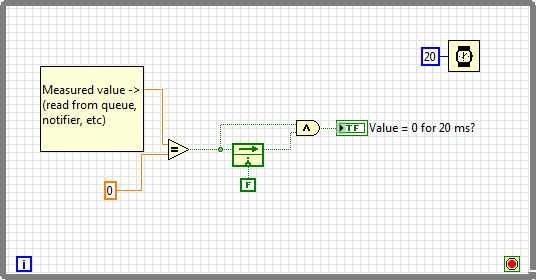

Hello Dgonz
From your description I assume you don't really need to implement counter, but you just need to check if measured value is equal to 0 for more than 20 ms. Here's a quick draft:
As nathand said, constant 1 ms timing in the loop is hard to achieve on non-realtime system. 20 ms seems far more reasonable.

PiDi - the possible problem with your approach is that the signal could be zero for up to almost 40ms before the indicator would come on, instead of 20ms.

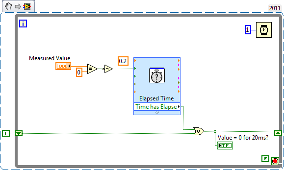

I would use a VI to keep track of the time.  Luckily, LabVIEW has one Smiley Very Happy
This poles every 1ms.  The shift register is to keep track if the time has elapsed.  Without the shift register, we are not quick enough to see the time elapsed go high and then back to false.

One minor problem: 0.2s = 200ms, not 20ms.  Also, the "Not Equal to 0" function is a lot more compact and does exactly the same thing.  Of course, an analog signal is often close but not equal to 0, so the original poster might need a bit more logic.

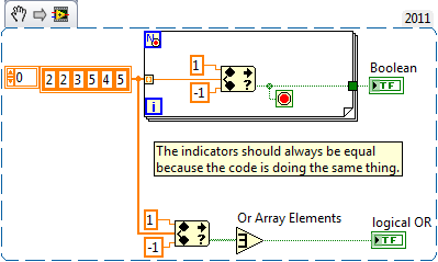

Thanks Lewis_G that is what I needed.  I'm still having a problem though.  I pull in the waveform, get the Y component, check that it is between 1 and -1 volt, but it is in an array and I need a single dbl to reset the Elapsed time function.
I have attached an image of the VI.  For some reason when I pasted it into the message body it ran me over the character limit.
This is the error I'm getting.
"These cannot be wired together because their data types do not match.
The type of the source is 1D array of boolean (TRUE or FALSE)
THe type of the sink is boolean (TRUE or FALSE)"
Any ideas anyone?
Message 7 of 9
(4,442 Views)
How many data points are in your waveform?  Where is the waveform coming from?  If you're only reading a single sample at a time then this is easy: just insert Index Array.  Another, possibly better, option is to replace the acquisition with a single point instead of a waveform.  If you're acquiring multiple data points at a time, then you may want to check each point in the waveform (depending on the requirements of your application).
The function you want is "In Range and Coerce" to check if the value is between -1 and +1.  There's never a need to do an equality comparison between a boolean and a constant - for example, equal to false is exactly the same as NOT.
You may want to read through some of the LabVIEW tutorials and getting started guides.
Message 8 of 9
(4,427 Views)
If you are dealing with a waveform (array of data), you could use the Or Array Elements function.
