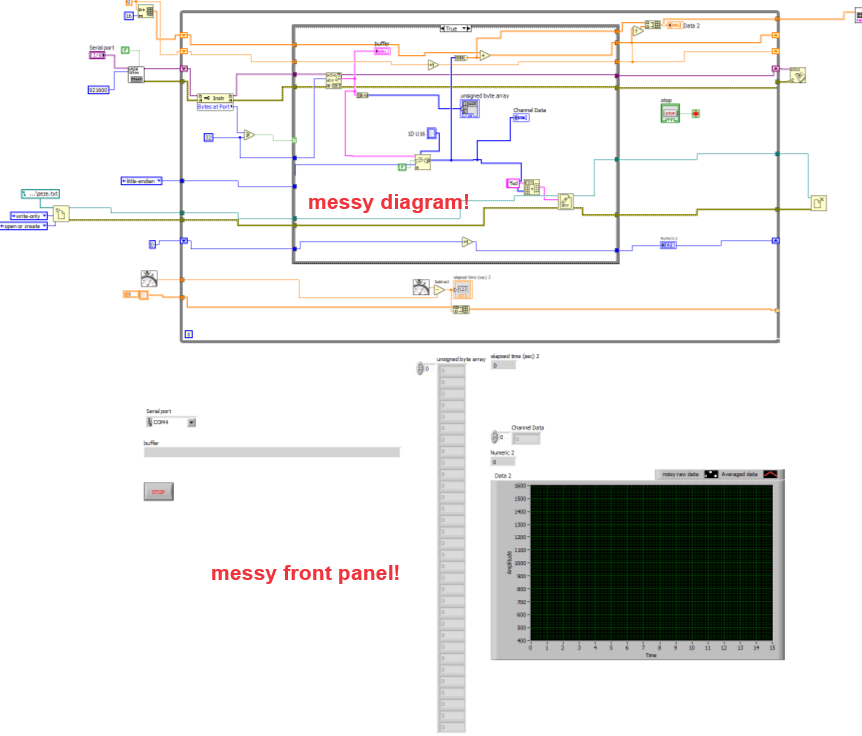

@Hasham622x wrote:
Yes, you are right; it was my mistake to add a FOR loop. With the help of guidance and suggestions shared by all, now, my code is working fine. I attached the code.
Kind regards
Hasham
It doesn't look fine.  It looks like a mess.

@Hasham622x wrote:
Could you please guide me on how I could make it neat and clean with the same working? I know I put time elapsed and same time average option then display and save average values in a separate file and also saved RAW data as well.
There is a cleanup button in the toolbar, and if you press it and the diagram gets worse, you have "clean code" in my definition (In your case is gets an order of magnitude cleaner, meaning it was a horrible hairball before!
Here's your diagram and front panel, but I am sure you've seen it already. If you look up "messy diagram" on Wikipendia, you would probably find exactly this picture! 😄 If the number of wire bends is a very large multiple of the number of wires, something is wrong.

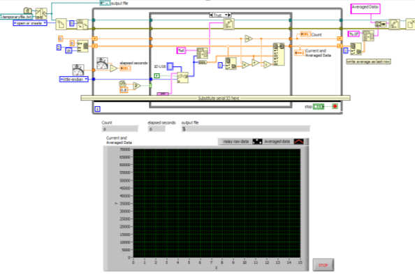

In comparison, here's how it could look cleaned up:
Here's how it could look (I don't have you serial stuff, so you need to again substitute that).
It is still not great to do file IO after the toplevel loop, because it will fail if the VI is aborted instead of stopped, but since you have all the non-averaged data saved, it can be reconstructed if needed.
