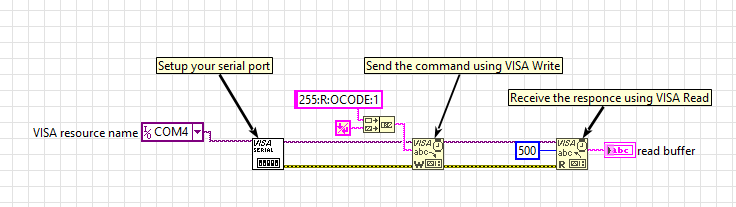

 Short answer LabVIEW uses NI-VISA to communicate with instruments on a serial port.
Now watch this video: VIWeek 2020/Proper way to communicate over serial
One potential gotcha with this program. The explicit adding of the EOL constant to the command string avoids the (very) common problem of having to deal with the display mode of the string constant. BUT it will only append a <CR><LF> on Windows computers. On old Macs it will only append a <CR> character and on Unix (Linux) and MacOS X it will append only a <LF>. So if your device expects an explicit <CR><LF>, you make your VI work on Windows only. If however your device will work with either and ignore two consecutive EOL marks, it will work regardless, and yes some smarter devices do exactly that, if their programmer did spend a few minutes to think about making the communication protocol a little easier to use and more tolerant to different computer systems communicating with it.
Just a shout out to be aware of this. The EOL constant may look like a good solution to avoid having to explain about the string display mode in LabVIEW to properly envision backslash escape codes, and it will usually work for typical development work, which is in over 95% of the cases done under Windows. But try to reuse such a driver for your cRIO project, which is running under Linux on the target, and suddenly your device may act badly or not at all anymore.
