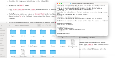

Hi there,
I would be very grateful if anyone can help. I recently downloaded the community edition for my home laptop for personal projects however for whatever reason the activation won't work so am trying to uninstall and I will just use my work laptop instead which runs windows.
However after following the uninstall guide on NI online whereby it says to copy Uninstall.sh to your drive and run my Mac won't even allow me to open the uninstaller file I simply get a
"Apple could not verify “Uninstaller” is free of malware that may harm your Mac or compromise your privacy."
message.
Please would someone be able to help as I am lost as to how to uninstall this software.
Dragging to the bin doesnt work at all.
I am running MacOS Sequoia 15.4
Any help is appreciated
(1,396 Views)
To Add to my request for help I have now got the file to run from inside the folder however once it advises deleted Labview still exists. lease see screenshot.
(1,349 Views)
To help anybody else I found another post which helped although wouldn't quite work due to the NI permissions set on the uninstall.command file.
To delete everything except now I am left with the NI help preferences only you have to edit the file as stated in the other post (absolutely no credit to myself).
I had to drag the delete file onto desktop and then go to get info and remove all of the permissions other with you can't edit it. then run as per the guide.
Type cd (space) in terminal then drag the directory file into terminal and hit enter.
Complete text that should be in the .command file;

sudo rm -rf "/Library/Application Support/National Instruments/LabVIEW CLI"
sudo rm -rf "/Library/Application Support/National Instruments/Errors/English/LabVIEWCLI-errors.txt"
sudo rm -rf "/Library/Frameworks/nilvcli.framework"
sudo pkgutil --forget com.ni.pkg.nilvcli &> /dev/null
fi
# These files may be shared between multiple LabVIEW and Runtime Engine versions
IS_EMPTY=$(ls "/Applications/National Instruments" /Library/Frameworks| grep -c LabVIEW)
if [ $IS_EMPTY -eq 0 ]; then
echo "Stopping the NI Service Locator..."
SERVICEFOUND=$(sudo launchctl list | grep -c com.ni.ServiceLocator)
if [ $SERVICEFOUND -ne 0 ]; then
sudo launchctl unload /Library/LaunchDaemons/com.ni.ServiceLocator.plist
fi
sudo rm -rf "/Library/Application Support/National Instruments/Service Locator"
sudo rm -rf "/Library/LaunchDaemons/com.ni.ServiceLocator.plist"
sudo pkgutil --forget com.ni.LabVIEWServiceLocator &> /dev/null
sudo pkgutil --forget com.ni.LabVIEWServiceLocator.Launchd &> /dev/null
sudo rm -rf "/Library/Application Support/National Instruments/LVComponentLocationInfo"
sudo pkgutil --forget com.ni.pkg.jsonmap &> /dev/null
echo "Uninstalling NI Offline Help Viewer..."
sudo rm -rf "/Library/Application Support/National Instruments/LabVIEW Offline Help Manual"
sudo pkgutil --forget com.ni.LabVIEWOfflineHelpManual &> /dev/null
sudo "/Library/Application Support/National Instruments/Offline Help Viewer/Uninstall.command" &> /dev/null
sudo rm -rf "/Library/Frameworks/niws_repl.framework"
sudo rm -rf "/Library/Frameworks/nicurl.framework"
sudo rm -rf "/Library/Frameworks/nilibeay.framework"
sudo rm -rf "/Library/Frameworks/nisslinit.framework"
sudo rm -rf "/Library/Frameworks/nissleay.framework"
sudo rm -rf "/Library/Frameworks/NILVRuntimeManager.framework"
sudo rm -rf "/Library/Application Support/National Instruments/nissl"
sudo pkgutil --forget com.ni.niwsrepl.LibFwk.pkg &> /dev/null
sudo pkgutil --forget com.ni.nisslcerts.LibAppSupp.pkg &> /dev/null
sudo pkgutil --forget com.ni.nissl.LibFwk.pkg &> /dev/null
sudo pkgutil --forget com.ni.nicurl.LibFwk.pkg &> /dev/null
sudo rm -rf "/Library/Frameworks/niPythonInterface.framework"
sudo rm -rf "/Library/Application Support/National Instruments/NIPythonInterface"
sudo pkgutil --forget com.ni.pkg.nipythoninterface &> /dev/null
sudo rm -rf "/Library/Frameworks/tdms.framework"
sudo pkgutil --forget com.ni.pkg.tdms &> /dev/null
sudo rm -rf "/Library/Application Support/National Instruments/NI Spy"
sudo pkgutil --forget com.ni.LabVIEWNISpySupport$LV_VERSION_RECEIPTS &> /dev/null
fi
if [ "$1" = "-q" ]; then
echo "Removing preferences and LabVIEW Data directories..."
sudo rm -rf "~/Library/Preferences/LabVIEW.app $LV_YEAR Preferences"
sudo rm -rf "~/Documents/LabVIEW Data"
fi
IS_EMPTY=$(ls "/Applications/National Instruments" | grep -c .)
sudo rm -rf "/Applications/National Instruments"
fi
IS_EMPTY=$(ls "/Library/Application Support/National Instruments/Errors/English" | grep -c .)
sudo rm -rf "/Library/Application Support/National Instruments/Errors/English"
fi
IS_EMPTY=$(ls "/Library/Application Support/National Instruments/Errors" | grep -c .)
sudo rm -rf "/Library/Application Support/National Instruments/Errors"
fi
IS_EMPTY=$(ls "/Library/Application Support/National Instruments" | grep -c .)
sudo rm -rf "/Library/Application Support/National Instruments"
fi
IS_EMPTY=$(ls "/Library/Preferences/National Instruments" | grep -c .)
sudo rm -rf "/Library/Preferences/National Instruments"
fi
echo
echo "The Dock may be unresponsive for several minutes after this process is completed."
echo "Uninstallation complete."
else
echo "Uninstallation canceled."
fi
echo "Press any key to continue."
read -n1 -s
They drag the uninstall file into command and hit enter and it should (fingers crossed) delete.
