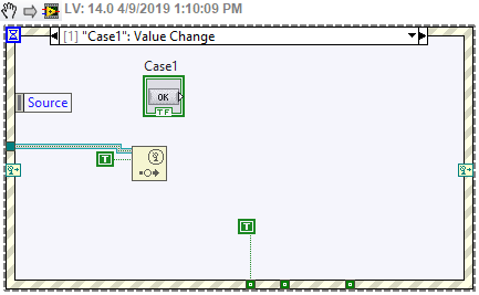

You are missing the generate user event call, that I had put in the "Case1:Value Change" event case (see below).
Notice that I am not sure what you are trying to accomplish. I have just answered your specific questions about user events.

Got it. Thanks so much. I have it working both ways now but the Generate event method is better and would allow event cases to cascade one after another.
