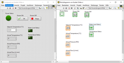

I watched a few videos and tried both your suggestions (simple serial example and the GPIB). Sorry that the images are in German but I accidentally installed the German version and you can't change the language settings after installation...
simple serialsimple serialGPIBGPIB
The good thing is, that all the ports from my device manager are detected. Bad thing is, that nothing happens when I press play. That would be too easy I guess 🙂
So then I started with a simple design. Something like this would be sufficient for my needs.
My ExampleMy Example
I guess that that is the "easy part" you were talking about....(still kind of made me proud that I managed to get this done).
So that is my status now. I guess I will read some more tutorials and see how I can now connect my layout with the RS232 stuff and hope for some more feedback from you guys 🙂
@Henrik: I only need simple things. Something like saving data and keep track of the values would be future music. I only need the actual temperature, maybe be able to change it and look out for alarms (no water in the tank or the chiller is shut down).
Message 8 of 44
