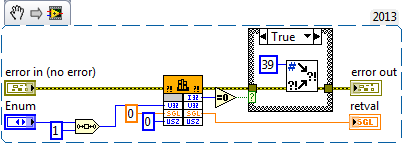

There was a problem in configuring the VoltType. It needs to have a cluster of bits.
Here is the screenshot.
(3,682 Views)
That looks quite a bit like a Rube Goldberg solution. Most likely the code you show is equivalent to this:
Rolf Kalbermatter  My Blog
