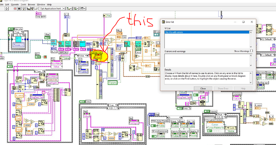

In the LV 7.0 the program is opened normally, but in the LV 2012 have many errors

You have a value property node that exists in one image, and is missing in the other.  just to the right of a False case structure, and a bit to the left of the Error List dialog box.
Somehow that got deleted in the one version.
In LV 8.2 or thereabouts NI rewrote the charts and graphs and in the process we lost the ability to access the cursor legend by right-click create ref >>> Property node.
There is a snow ball's chance in HE@# that if that code is updated to LV 8.2 there may have been migration code.
Otherwise will require a rewrite to work with modern LV.

I guess that it's because in LV2012 property of control/or control type at all does not exist - thus property node for value of some control/indicator is just dissapeared. I don't have LV 7, so I can't go so deep, but I guess that you could check it by yourself also (I've highlighted that place).property node Value.PNG

Yes the old graphs got replaced and the access to the cursor legend changed drastically.
See this link.
I have always thought NI did not think any of ever found that approach. WRONG!
