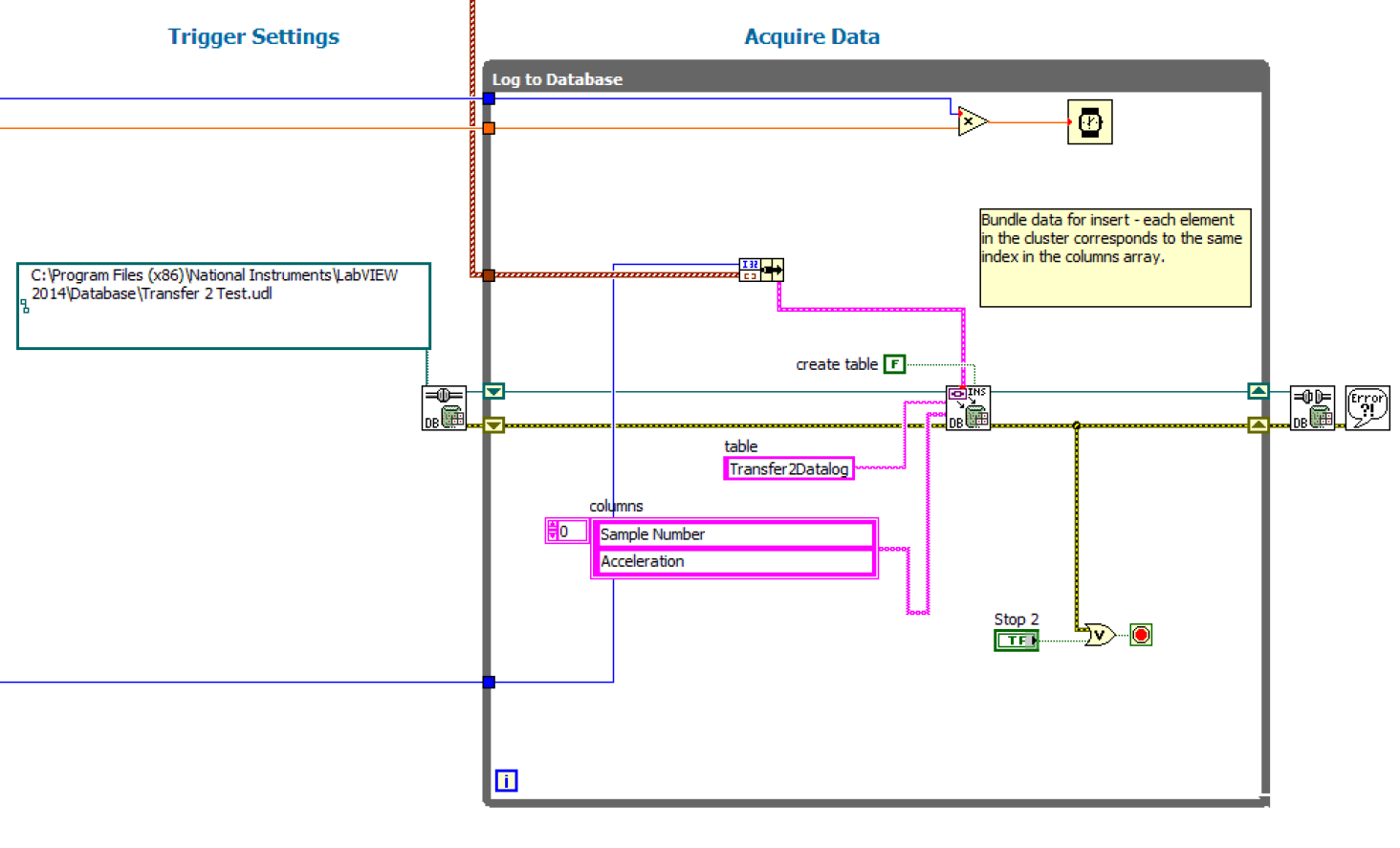

What was your solution? I'm having the same issue.
I'm trying to create a table of accelerometer data using the Database Logging example VI. I've attached the VI I'm working with so you can help me step through this... If you look under the "Acquire Data" heading, you'll see a while loop that contains the database logging code I'm having trouble with. I've created a .udl file that successfully connects to the SQL server I want to write my data to, but I can't seem to get it to create a table and write my data to it. I've used my number of samples as the input for the number of rows in the table, and my sample clock timing as an input to the Wait function for the while loop iterations.
Any ideas? I'm stuck...

Here's the portion of the VI that handles the data exchange with the SQL server. I can post other areas of the VI if that will help. The wait function is using my sample rate and total number of samples to determine when to send the data to the server. The integer input into the table comes from the total number of samples (so it will create 1 table row for each sample).

Right now, your code has boolean set to False for creating a table.
Yet in your first post, you write that you want to create a table.
