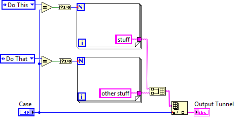

-If this was purely a theoretical exercise, then I'd offer the following as a possible solution to your logic puzzle:
At the very least it'll allow you to specify a single code path to execute.
Don't do this in any real application.  It won't make you happy, it won't make the customer happy unless they really don't understand the environment, everyone loses.  It would be a nightmare to scale or maintain with any sort of complexity.
