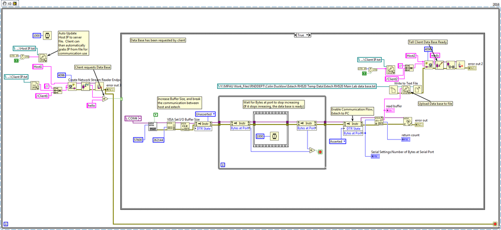

So I have an application that is made to communicate between 2 separate computers using the stream functions.  It work's great in the normal project/VI, but when I make the Client side VI into a .exe, it always says the network stream is busy.  Error picture is attached.

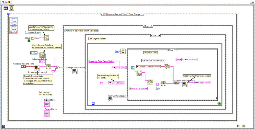

Sorry About that, here are the snippets.  I hope the sub VI's go with it?

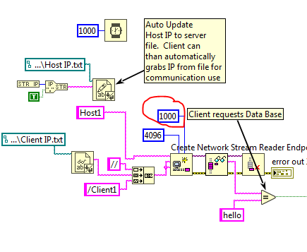

The problem was in the Host VI.  The address would stay at the create network stream port forever.  Giving it a timeout of 1000ms allowed it to refresh the network stream!  It works!

At first I noticed that when switching back and forth between computers using the Client VI, I had to restart the Host VI to get rid of the network collision error message. I believe that was solved by the timeout, but I'm not sure.. I haven't had much time to check it in the last day, but I think it worked.  The executable seems to work on other peoples computers, but not my own.  Perhaps there is an issue running the client and host VI on the same computer?
BUT
Then again, I can run the "non exe" Client VI and Host VI on the same computer and it works perfectly fine.  I'll try to find some time to test this more my self tomorrow, other wise I won't be able to until next Wednesday.
