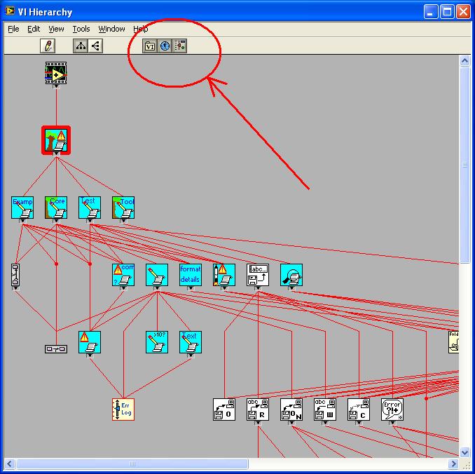

In LV 8.2 the Hierarchy screen forgets the view settings so that when you re-start LV it is back to the default.
Sub-bug #1
The buttons that let choose to see the VI's in VI.llb, globals, and typedefs default to false. See image.
Sub-bug#2
The setting to "show full VI path in label" is alos forgotten!
Previous version of LV would remember these settings!
These are not "show-stoppers" bugs but they are "ease-of-use" bugs.

This was reported to R&D (# 437A7NG0) for further investigation. Thanks for the feedback, guys.  LV 8.0 shows the same behavior, so 7.1 was the last version that remembered these settings.  Also, Ben I don't see what you mean by the VI.LIB setting being off by default.  When I tried it (and according to your screenshot) these three settings are all on by default.

Thank you Doug,
You are correct, I should have typed "True".
The second sub-bug refers to "View >>> Show Full VI Ptah in Label" defaults to NOT show the full paths.
