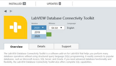

Whenever i try to install anything from version 2018 or earlier, i have to download it manually from the website, because NI Package Manager doesn't show me an option to download anything other than 2019 and 2020 versions.
I am logged in and have professional license and can download older versions online, but NIPM won't show em.
Am i doing something wrong or is this just the way it is?
Example with database connectivity toolkit:

Hi Soul,
answer: NIPM was started with LV2018 - it simply doesn't know anything before that!
You need to download the installation packages from NI's website for older LabVIEW versions…

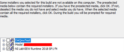

This is somewhat unrelated to original topic, but the reason why i wanted older Labview version was to build an app in it.
Tried to build an app, but it said there are no DAQmx drivers for that version, so i tried installing version 18.6 of DAQmx drivers.
Installation was aborted because i already had newer version of drivers and old could not be installed.
So i went into 2019 version in which i already had the app built and tried making an installer... but the drivers, despite showing up on the list and being selected
are apparently unavailable
DAQmxTest is an app i built in version 18 on another computer, but doesn't actually contain an installer for DAQmx.
What am i doing wrong here?

Hi Soul,
when I install LabVIEW then I copy the content of the USB installation media onto the harddrive of the computer -  and leave that on the computer after installation.
This way the AppBuilder always has access to all needed setup packages…
Message 7 of 11
(5,120 Views)
