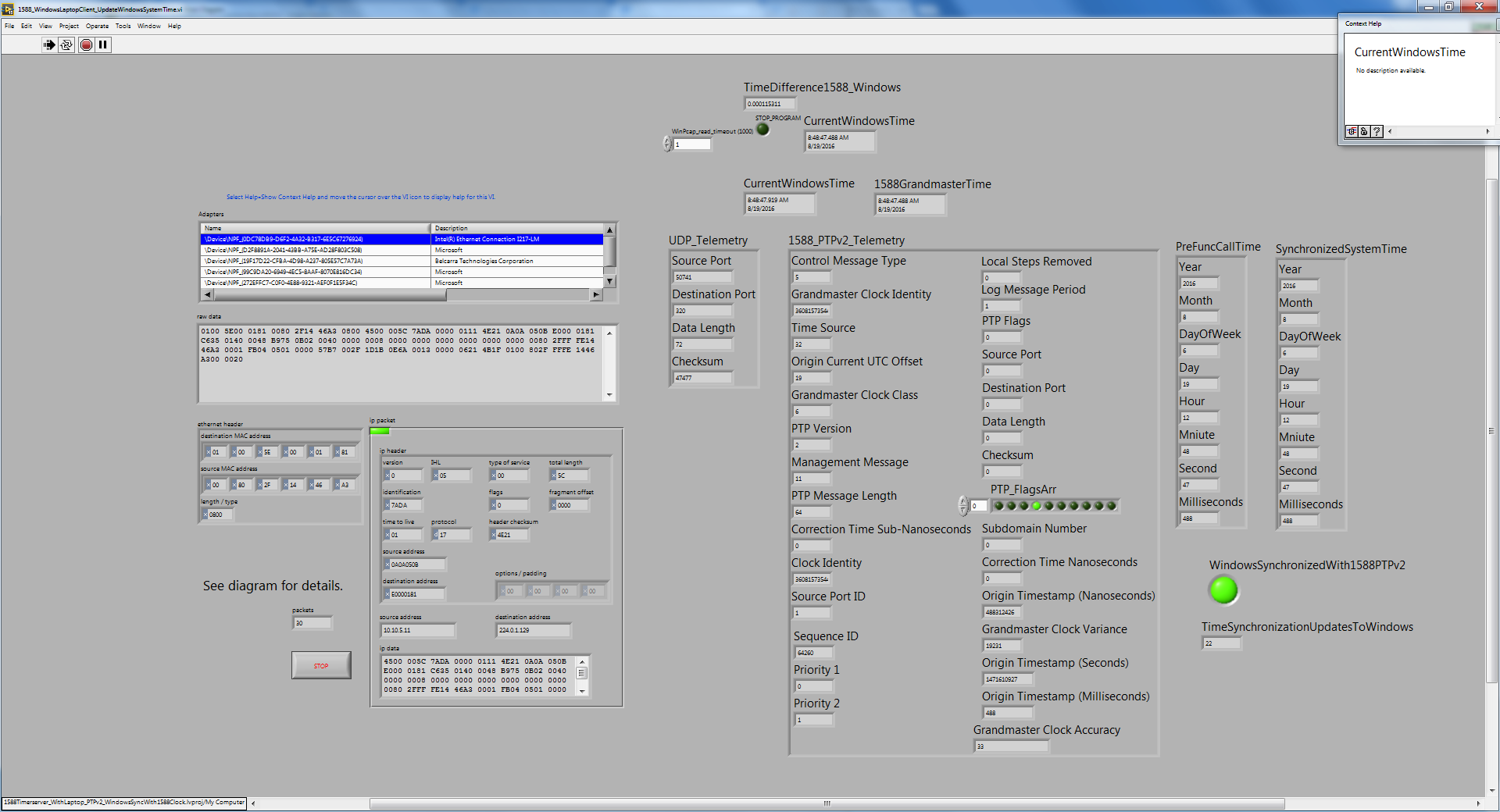

SOFTWARE 1588 PTPv2 WORKS ON THE WINDOWS 7 LAPTOP!!!!
At the top of the front panel indicator "timeDifference1588_Windows", I compare the difference between the received 1588 PTPv2 time and the local Windows 7 system time on the Laptop.

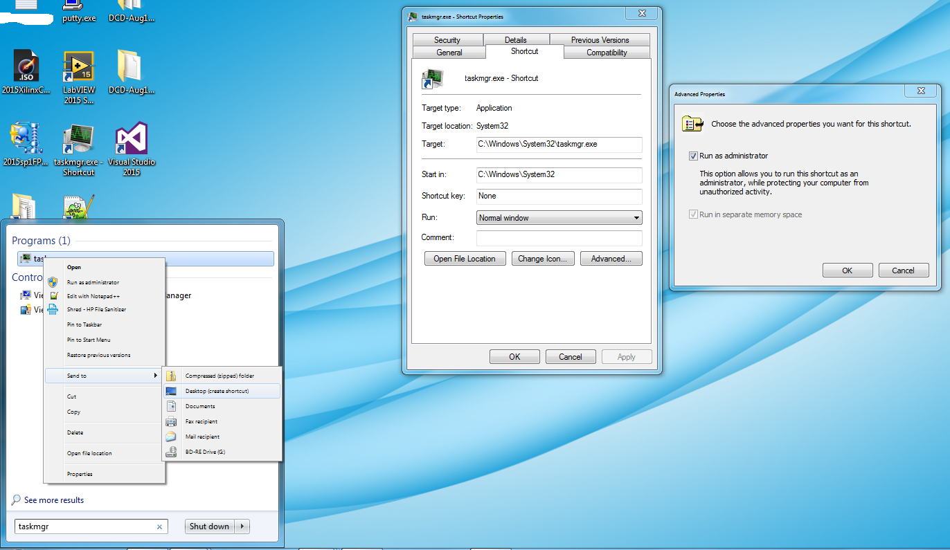

1) Up LabVIEW's priority in Task Manager
a) type taskmgr into the bottom search bar
b) right click-->send to...-->create desktop shortcut
c) right click on the shortcut you just made on the Windows desktop --> select properties --> advanced
d) select "Run as administrator"

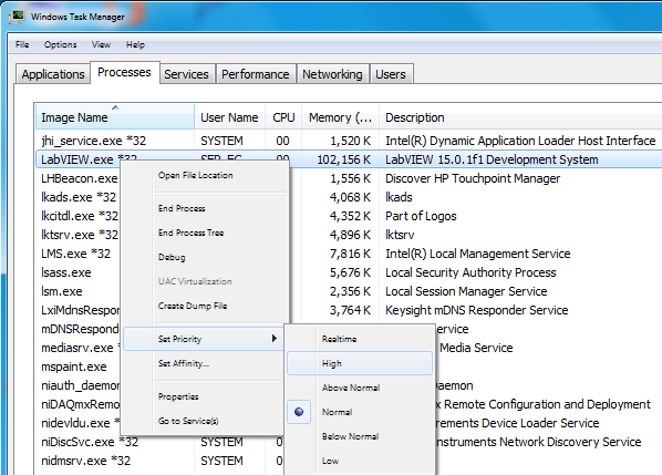

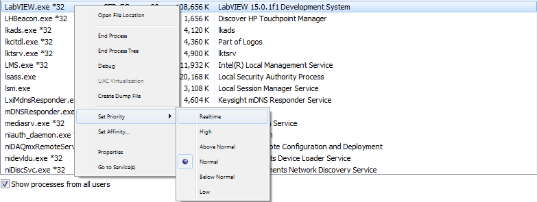

2) Now increase the priority of LabVIEW on your windows machine to get closer to real-time performance for the 1588 time server
a) Go to "processes" tab and right click on Labview and set priority to High
DO NOT SELECT "REALTIME"!!! IT WILL MAKE WINDOWS UNRESPONSIVE AND LabVIEW WILL LOCK UP YOUR COMPUTER!!!

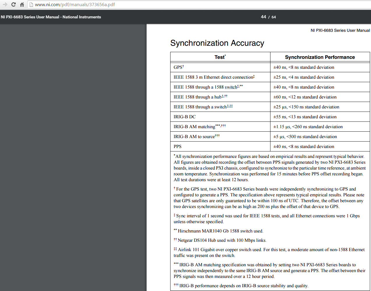

We will use a 1588 capable switch (costs around 5k, but will significantly help because the network switches of this caliber actually offset the time across the switch to make the time from the grandmaster more accurate).
Table for possible switches to order (viewed from the 6683 user manual):
Please see the attached WORKING projects for use with a windows Laptop using software PTPv2 and a PXIe using hardware NI-6682 1588 PTPv2.
The Laptop project runs on any Windows 7 computer.
I also included code for a cRIO to be used with 1588 per this forum discussion: http://forums.ni.com/t5/LabVIEW/NI-Sync-with-cRIO-9035/m-p/3332756#M977815
The PXIe/cRIO project contains both LabVIEW code to start the PXIe grandmaster and also LabVIEW code to monitor 1588 PTPv2 on a cRIO-9035.
