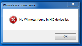

No Wiimotes found in HID device list
We are working on a new project based on the "LabVIEW interface to a Wii Remote ("Wiimote")" code available here: https://decibel.ni.com/content/docs/DOC-1353
We are using a new Wii MotionPlus remote with an older Bluetooth Dongle on Windows 7. The Wiimote pairs correctly with Win7 using the Add Device screen.
When we try to run the "WiimoteTest.exe" program provided in the WiimotLib_1.7 zip package, we receive the following error.
"No Wiimotes found in HID device list."

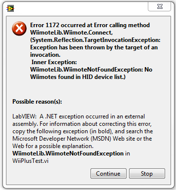

Same error as before:
Still working on a connection with the a new Wii MotionPlus Remote...

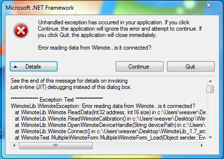

After running the WiimoteTest.exe, the Microsoft .NET Framework throws a host of exceptions. The screen capture below does not show all of the information, only the top of the list:

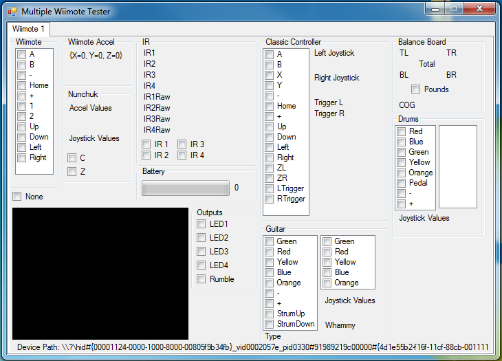

After pressing continue, the Multiple Wiimote Tester UI loads and is displayed correctly, however, there are no readings from the Wii Remote displayed.
When the buttons are pressed on the Wii Remote, the check marks are correctly displayed (such as the A & B buttons, et. al.) and the Rumble actuates when the Rumble check box is clicked with the mouse.
No accelerometer values. No IR values. No Battery level.
Will continue debugging for the Wii Motion Plus remote.

WiimoteLib.WiimoteException: Error reading data from Wiimote...is it connected?
   at WiimoteLib.Wiimote.ReadData(Int32 address, Int16 size) in c:\Users\weaver\Desktop\WiimoteLib_1.7_src\WiimoteCS\WiimoteLib\Wiimote.cs:line 1196
   at WiimoteLib.Wiimote.ReadWiimoteCalibration() in c:\Users\weaver\Desktop\WiimoteLib_1.7_src\WiimoteCS\WiimoteLib\Wiimote.cs:line 933
   at WiimoteLib.Wiimote.OpenWiimoteDeviceHandle(String devicePath) in c:\Users\weaver\Desktop\WiimoteLib_1.7_src\WiimoteCS\WiimoteLib\Wiimote.cs:line 259
   at WiimoteLib.Wiimote.Connect() in c:\Users\weaver\Desktop\WiimoteLib_1.7_src\WiimoteCS\WiimoteLib\Wiimote.cs:line 136
   at WiimoteTest.MultipleWiimoteForm.MultipleWiimoteForm_Load(Object sender, EventArgs e) in c:\Users\weaver\Desktop\WiimoteLib_1.7_src\WiimoteCS\WiimoteTest\MultipleWiimoteForm.cs:line 59
