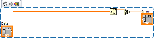

A few problems along the way.
The type of your data array out of the spreadsheet conversion VI should be complex double, not double
Wire an indicator from the error out of the LM VI to double-check for errors.
The parameter order was not consistent between your initial guesses and the order used in My ComplexFunction.vi
You left some commas in your string
Here is my version incorporating your spreadsheet conversion.  The default values you see are what I get when it runs on my machine, so clearly the fit is "working".  Working doesn't necessarily mean giving good values, it only does what it is told.  Better guesses and constraints on parameters are sometimes needed to help out.  In this case, your guesses look good.
Edit:  Fit shape looks good, values are a little unrealistic.  Usually either a function choice problem, or large uncertainties in the parameters.  Constraints may help, harder to do in 8.2.
