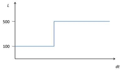

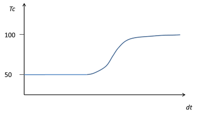

Hi altenbach,
Tc = current temperature
T = initial temperature
As shown below, a step change in L (y) results in a temperature change up to new steady-state temperature.
I need to model this temperature change function.
(3,208 Views)
